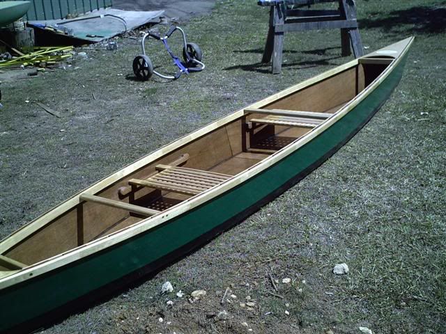

G'day David,
I think your Beech ply is similar in properties to what we call bracing ply. We use it mostly structurally as in building houses etc. Aussie Hardwood veneers - very strong but also relatively heavy.
If this is the case, should be fine for the type of boats without too much torturing required. I built my Touring Pirogue with this stuff and it turned out really nice, only it is a little heavier than my other boats. (still lighter than fibreglass or plastic).

Hey Mick. If this is the case than should really be OK. It is true that it is strong and heavy. Your touring pirogue looks really great, very beautifoul!
