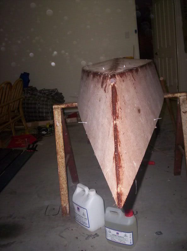

Ok is looking a lot more boat-like now. Filled in the seams I was pondering and thought: just do it! So did it, sanded it a bit and moved on. Put glass on and wet it out (naturally had to use wife's kitchen scissors, so am in the poo again) then realised I was gonna be late for work. Came home and all looking good apart from four little areas, bout 1/2 x 1 inch where it rested on the trestles where glass had lifted. Have clamped with plastic and they'll either bond overnight, or not. If not I'll cut them out and patch... Still looking at Mick's post bout photobucket. Am thinking of inventing a new thread called postbuild log

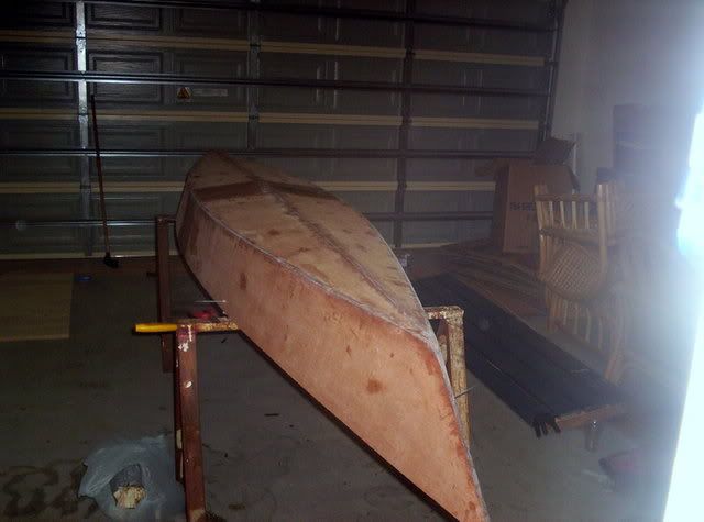

Well bugger me! it worked! Now I can do pics
Ok that pic was taken a day or so ago. Since then I've put glass on, a fill coat and a second fill coat on the bottom with graphite, very undermixed I might add, will have to make up for that on the next coat.
