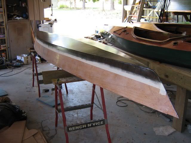

first coat of graphite is on.

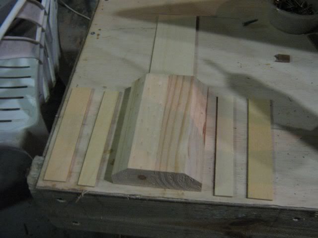

While that was setting up, I started working on a little deck tube thing. Sort of like a small glove box where Robin can keep her camera or something.
Component parts round the forming block.

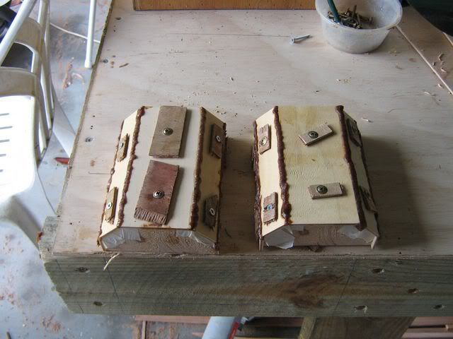

Ready for external fillets.
Glued up. Made one for me too. :P
I got two more coats of graphite on the bottom today and hope to flip her tomorrow and start on the internal fittings.

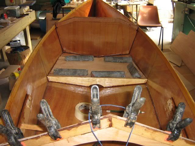

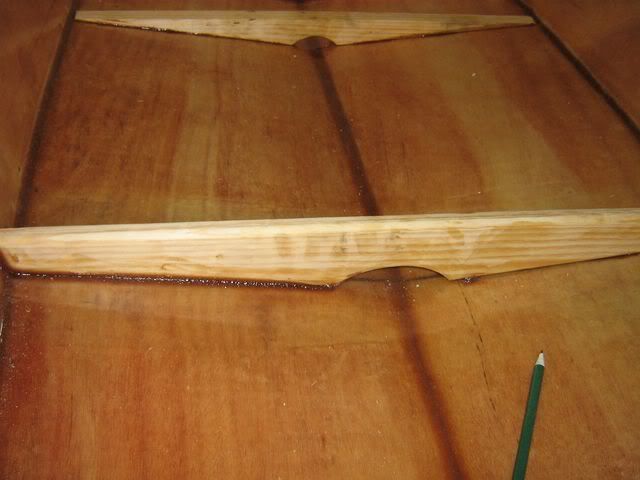

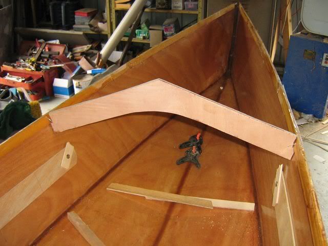

Seat supports are cut, fitted and in

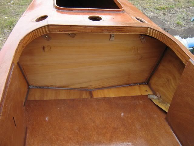

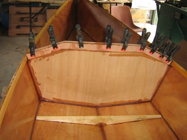

Cut and fitted a rear bulkhead, with shear clamps :P
Made one for me too :D

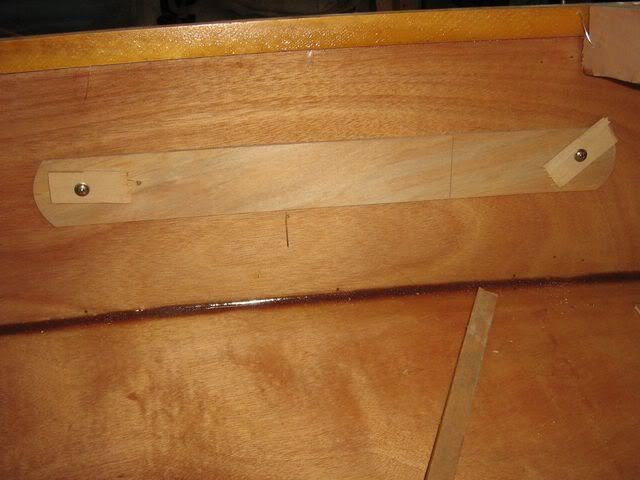

Foot brace backing plates are cut & fitted
Front deck support is also in. :D
Seat is in.
