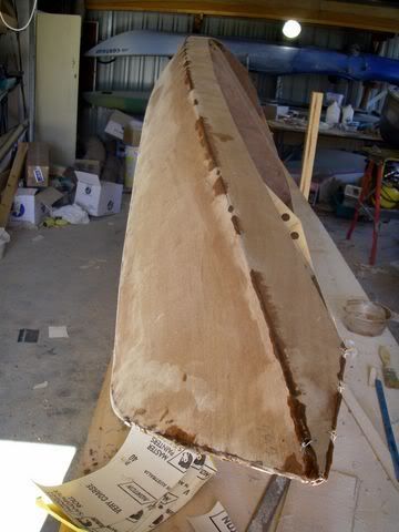

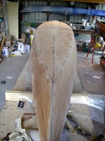

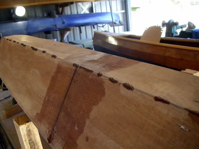

Been a little pre-occupied with other things these last couple of weeks but I think I have the roblems pretty much sorted now.
All panel stitches are removed and the exterior seams are filleted.
Hope to clean this up tomorrow and get a saturations coat of epoxy onto the outside.

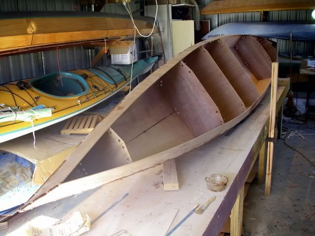

Getting a little done,

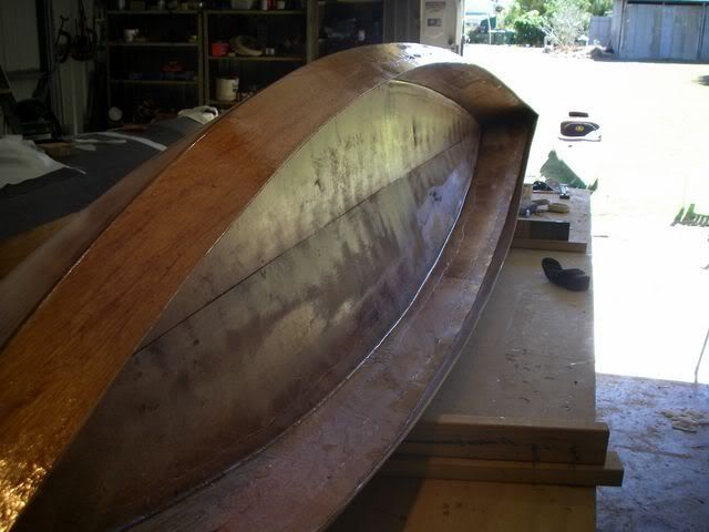

Temp frames out.

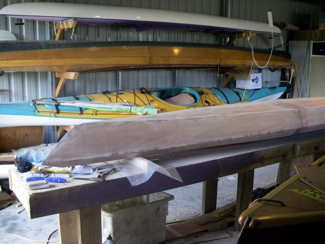

Hull outside is cleaned up

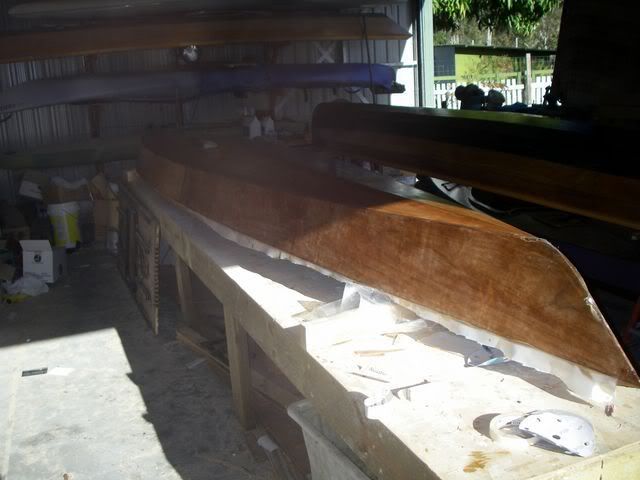

Hull has saturation coat of resin on and Letting fibreglass cloth flatten before putting on and wet out coat.
Probably later today.

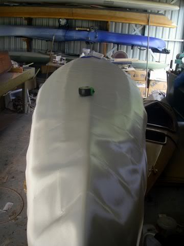

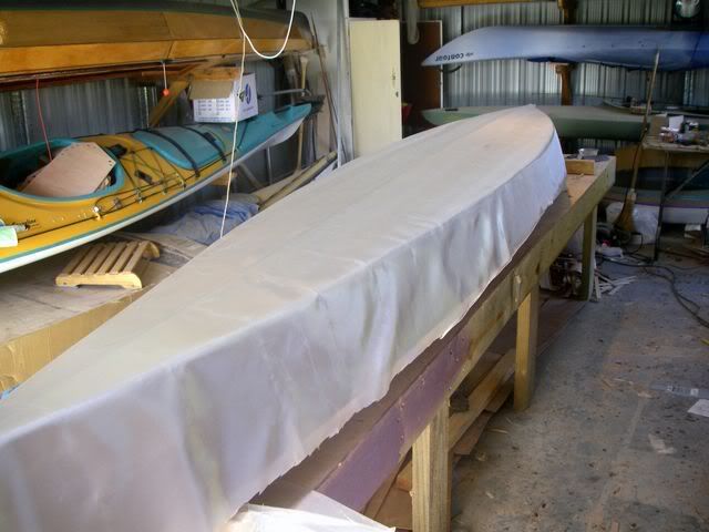

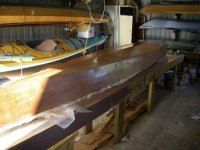

Moving right along,
I let the saturation coat on the outside go allmost touch dry, spead my tight weave cloth over it and trimmed where necessary.
By doing it this way, the tackiness of the resin holds it in place and I find it easier to work the cloth to conform to the hull shape.

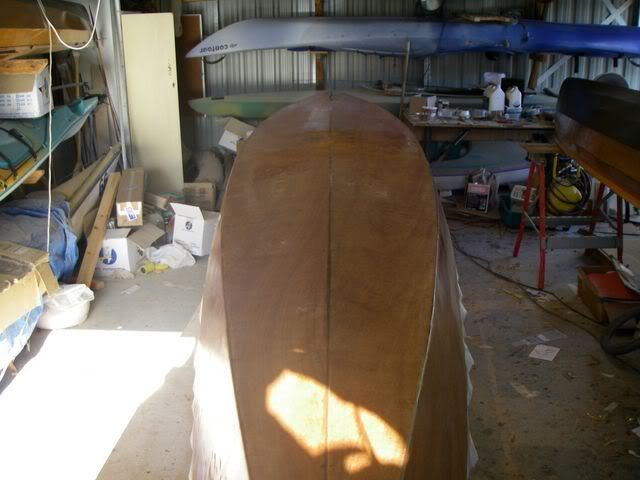

Wet out coat is on.
The little overlap on the tumblehome panels was worked into place once this coat got a bit tacky. (Much easier to do this way)
Been setting up about 4 hours now. Will go down the shed and throw the first filler coat on,
Wet out coat is on.

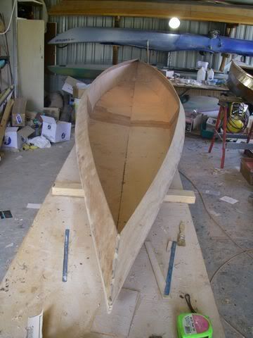

Plodding right along,

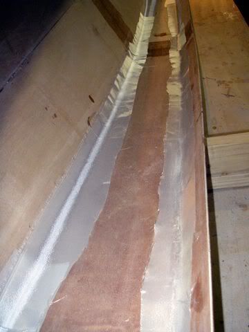

I have started filleting and glassing the inside. using the Duckworks light weight, tight weave stuff and it is a real PITA to work into the concave area of the inside.
Here is my solution. because I am using very good marine ply on this one and the outside is completely glassed, i am just sort of taping the side seams.

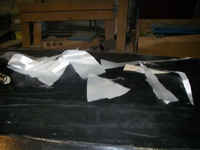

There is very little waste at my place. I have a bunch of off-cuts from this and other builds soooo, I cut them into about 3" stips and did this,
This is what is now left over.
One side is glassed and we out.
Will probably fillet the other side tomorrow.

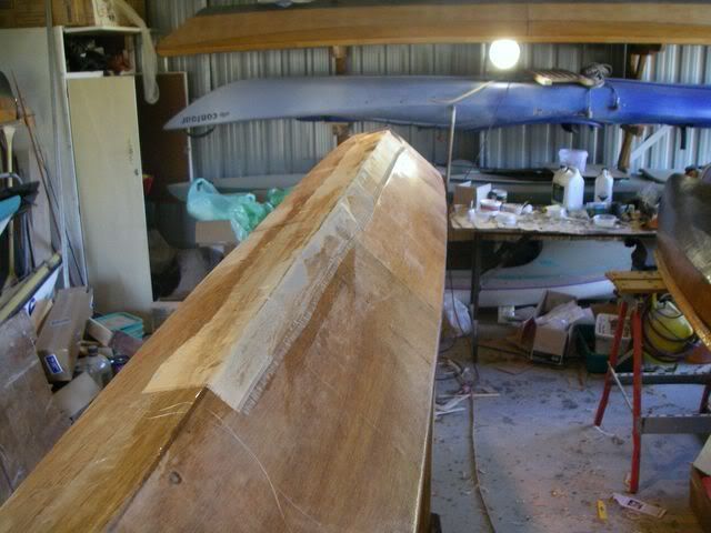

Still plodding away.
Other side is fillited and taped. This is waaaay easier thn trying to work the tight weave into all the corners.
While I was at it, I laid up a tape over the side to tumblehome panel seam where I mis judgede the width of the boat and cut my cloth too narrow.
waiting to be wetout.
