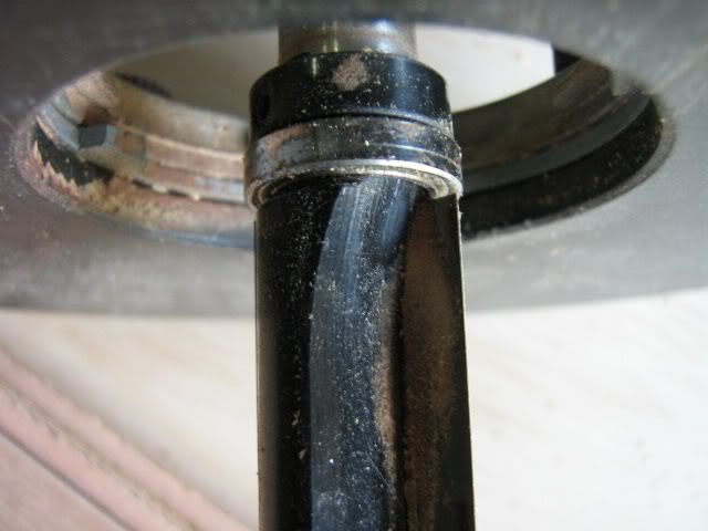

If you have a router, do yourself a favour and invest in a flush trim, or pattern bit like this
Screw your mirrored panels together and down onto your bench and runn around them wth it. very quick, very accurate, but be very carefull'
It is possible to do a complete, multi panel boat in a day using this method.
